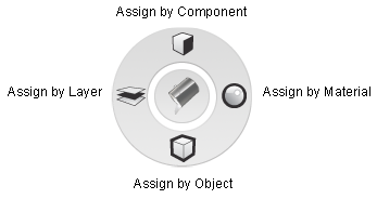

  1. Hold the and drag to select an assignment mode.
    Assign by Component
    Assign the active shader to a single surface or mesh.
    Assign by Material
    Assign the active shader to all the geometry that use the same material as the clicked geometry.
    Assign by Object
    Assign the active shader to all the components that are grouped in the same object.
    Assign by Layer
    Assign the active shader to all the geometry in the same layer as the clicked geometry.
  2. Select the shader you want to assign.
  3. With the , click the geometry or drag a box around it.

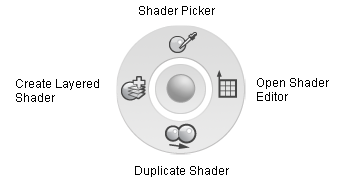

To pick a shader assigned to geometry and make the shader active
  1. Hold the and drag to select the Shader Picker tool.
  2. With the , click the geometry that has the shader you are picking. The shader assigned to the clicked geometry becomes active and the tool switches to the last active Apply tool.
To edit the projected texture assigned to geometry
  1. Hold the and drag to select the Open Shader Editor tool.
  2. With the , click the geometry that has the projected texture that you want to edit assigned to it.
    The Shader Editor displays, where you can edit the projected texture.
To duplicate the shader assigned to geometry
  1. Hold the and drag to select the Duplicate Shader tool.
  2. With the , click the geometry that has the shader you want to duplicate assigned to it.
    The shader assigned to the geometry is duplicated and then assigned to the geometry
To create a layered shader and add to it the shader assigned to geometry
  1. Hold the and drag to select the Create Layered Shader tool.
  2. With the , click the geometry with the shader assigned to it that you want add to a new layer.
    A layered shader is created and the shader assigned to the picked geometry is added to the new layered shader. The layered shader is then assigned to the clicked geometry.
