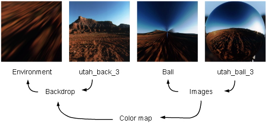

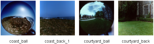

Ball Textures
The Ball texture uses an image (or series of images) of a highly reflective chrome ball in an environment (real world or computer generated) to re-create that environment. This is possible because the reflections in the chrome ball provide a (nearly) 360 degree view of the environment.
A Ball texture background renders faster than a procedural texture background or a background modeled with surfaces. You can therefore replace a complex background with a Ball texture (by rendering an image of a chrome ball in that environment) to reduce rendering times.
In order to use the Ball environment texture, you must map the texture’s Image parameter with the image of a reflective chrome ball in the environment you want to re-create. You should also map the environment’s Backdrop parameter with the image of the environment without the chrome ball.

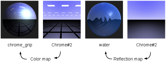

Chrome texture
The Chrome texture simulates a showroom environment. The texture consists of a ground plane and a sky plane (with fluorescent style light rectangles), and provides a simple but effective environment to simulate reflections off chrome surfaces.

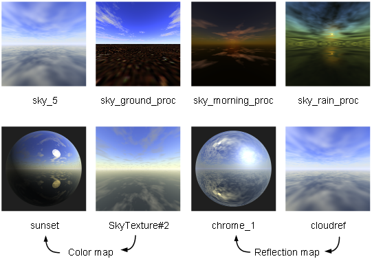

Sky texture
The Sky texture simulates a planetary environment viewed from the surface of a planet.
Note:
If the eye point or view drops below the floor, the Sky texture swatch in the Multi-lister turns red as a warning. If you render the scene, the floor appears red. Make sure that the eye point is always above the floor (the ground plane).
