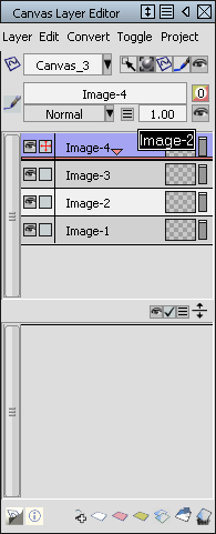

Use the left or middle mouse button to drag the image layer name in the Canvas Layer Editor window.
When a canvas plane contains more than one image layer, you can arrange the image layers in any order. For example, you can move an image layer so that it appears behind or in front of another image layer.
The order of the layers in the Canvas Layer Editor determines the stacking of the layers on the canvas. If a layer is above another layer in the editor, it will appear on top of that layer on the canvas.
You can move any number of image layers, mask layers, and folders at once.
The layer appears blue.
The new selected layers/folders appear in white.
A small pink arrow points to the location.
When you drag image layers with the
or
, a black box with the top layer name follows the cursor.
A red horizontal line shows where the image layer will be moved to (when you release the mouse button).
For example, in the picture above, if you move Image-2 upand release the middle mouse button with the red horizontal line below Image-4, Image-2 will be moved just below Image-4.
