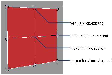

You can crop or expand the top, bottom, or side of a canvas plane to remove part of a sketch or to change the size and shape of the canvas plane. You can crop or expand a canvas plane using either the Marquee and Crop to marquee tools, or the Resize plane tool. The Resize plane tool also lets you move the canvas around while the image layers stay in place.

A manipulator appears on the canvas plane.
A confirm box appears warning that resizing cannot be undone.
The canvas is cropped, expanded, or moved along the new edges shown by the manipulator. The resolution (pixels per in/cm) does not change. The content of the image layers does not change size but gets cropped along with the canvas.

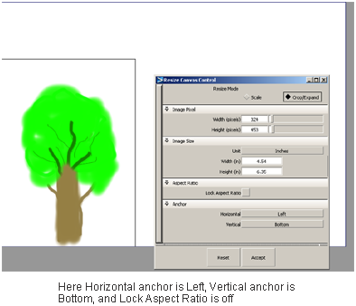

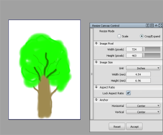

The control window allows you to enter precise numeric values for the new width and height of the canvas as well as specify an anchor point.
A black outline shows where the edges of the resized canvas will be.
The canvas is cropped or expanded according to the values you chose in the control window. The resolution (pixels per in/cm) does not change. The content of the image layers does not change size but gets cropped along with the canvas.
