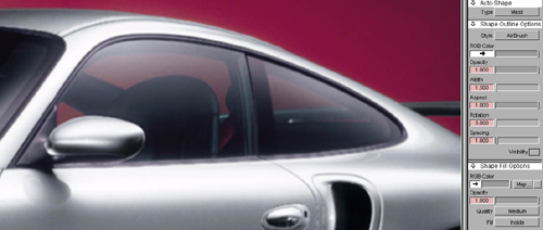

  1. Open the Paint Panel, expand the section called Global Auto-Shape, and select the type of shape you wish to create.
    In this example we will create a mask shape to protect the side glass area of this image.
    From this moment on, all Alias curve creation tools will create mask shapes on the current layer.

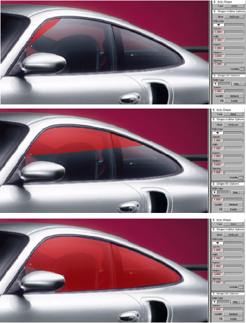

    In this example, we will create a mask shape using the CV curve tool.
    As you place CV points to define the curve, the image layer mask automatically updates to form a closed mask region.

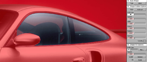

    The mask regions can be created with Fill set to Inside or Outside in the Shape Options section of the Paint Panel. This has the same effect as using Edit > Invert Layer in the Canvas Layer Editor.
