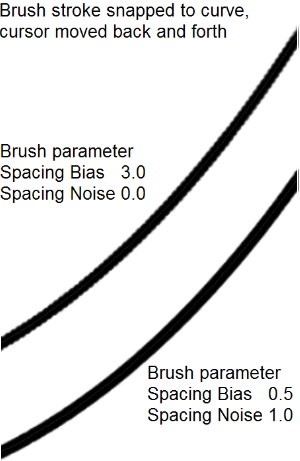

When sketching, find the balance between quality and speed. While a small brush stamp bias may improve the smoothness, it results in slower brush performance; using a large stamp bias provides additional speed, but may not provide the quality.

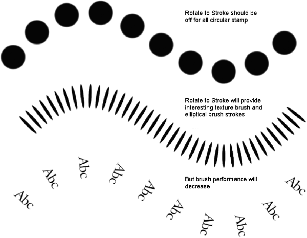

Try to avoid big texture brushes that have variable brush radius or rotate to stroke turned on, as the combination slows performance.

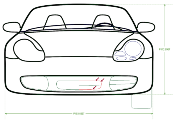

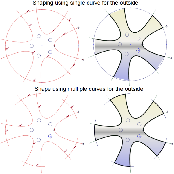

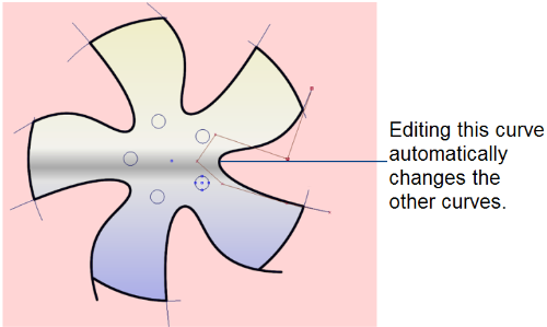

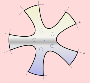

Convenient curve editing tools in Paint mode are:
CVs are turned on when you click on a curve after choosing the Transform CV tool. See Control Panel > Transform CV.
See Make curves intersect for details on using these two tools.
All of these tools can be accessed from the Shelf.

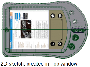

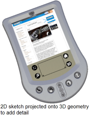

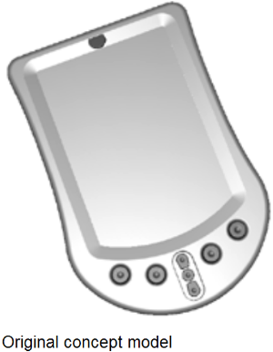

See the section Project a sketch to quickly add design details for more information.
