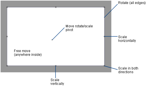

    A manipulator appears on the active image layer.
  4. Click and drag a manipulator handle to transform the image layer.
    When you move the mouse over the manipulator, a context-sensitive cursor shows the current transform mode (move, scale, rotate).

    To move only horizontally or vertically, hold the key and move the mouse in the desired direction. You can also use the arrow keys to move by small increments.
    To enter exact numerical values, use the text fields in the option box.
