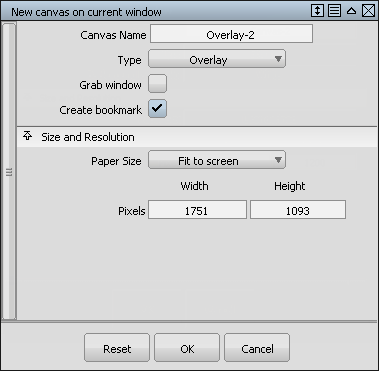

The default Paper Size is set to User defined and lets you choose a width and height for the canvas (in pixels). If you choose Fit to screen instead, the resolution will be set automatically so that the canvas plane is sized to fit the view window. You can also choose a standard paper size (such as A4, B2, C0, etc) or Custom if you want to specify the true dimensions of your canvas (in world size units). For a description of all the options:
See Canvas > New Canvas.
In a Perspective window, you can also choose the Type of Canvas: Standard, or Overlay.
Overlay canvases are canvases that are only visible from a particular viewpoint. They are used in the perspective window to create perspective texture projections, 2D roughs, or for annotation (and bookmarks) purposes.
See Canvas > New Overlay Canvas.

To create a new canvas plane
  1. Choose Canvas > New Canvas.
    The option box opens.
  2. Set the Orientation (view window), Background layer color, Paper size and resolution for your canvas, then click OK.
    A blank canvas plane containing one canvas layer and a background layer is created in the view you specified. The new canvas appears in a special Paint window, on top of the regular view window, ready for sketching.
