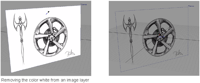

Remove a color by making it transparent
Select a color then use the Erase Paper plug-in.
This feature is available in all Alias products.
How to make all areas containing a given color transparent
  1. Choose Utilities > Plug-in Manager and select the erasePaper plug-in in the Paint section (put a check mark in both columns).
    The Erase Paper tool plug-in is added to the Paint Edit palette.
  2. In the Canvas Layer Editor , select the canvas and layer you want to affect.
  3. Select the color you want to make transparent. (Choose a Brush tool to open up the color swatch in the upper left corner of the interface, which displays the default brush color.)
    The quickest and most accurate way to select a color is by using the eye dropper. Click the eye dropper then click the color you want on the canvas.
  4. Choose Paint Edit > Erase Paper
    The color is removed.
    Note:
    In Design and Automotive, and AutoStudio the image layer is duplicated before the color is removed. The new layer contains the original un-erased version, which you can access through the Canvas Layer Editor.
  5. Repeat the process for another color, or another layer, if needed.
