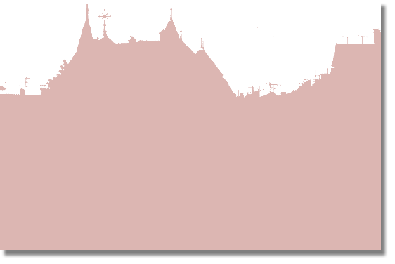

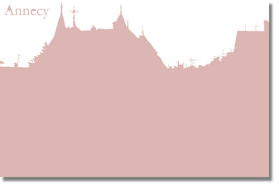

Notice that the Paint Panel now displays the Magic Wand Options.
The sky appears unchanged, but the rest of the image becomes pink.
The pink color indicates regions that are not selected. (Regions that are not selected are also referred to as masked regions.)
Regions that are not pink are selected regions (or unmasked regions).
Now you can only modify the selected regions (for example, painting, erasing, copying, and so on).
You cannot modify the pink (masked) regions.
For example, set it to 100, 120, 130, and finally 20.
Notice that the text in the top left corner is not selected (that is, it appears pink).

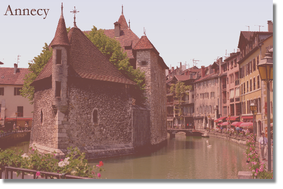

A new mask layer called Marquee-# (where # is a number) is created in the bottom section of the Canvas Layer Editor and becomes the active layer.
Regions of the mask layer that contain red paint represent areas of the active image layer that are masked, and regions of the mask layer that do not contain paint represent regions of the active image layer that are not masked (paintable).
Here we want to modify the mask by painting directly into the mask layer.
Now these regions are unmasked.
(If there were any masked regions within the sky, for example clouds, you could remove them in a similar way.)

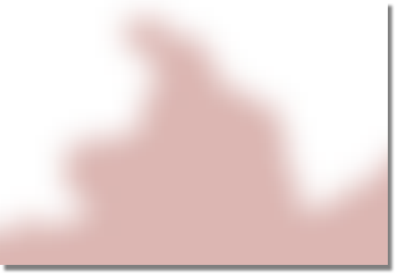

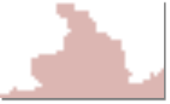

Notice that the edge of the masked region is very abrupt and jagged.
Another modification we can make directly to the mask layer is to blur it so that the edge of the masked region is smooth.
Now the edge of the masked region is much more smooth.

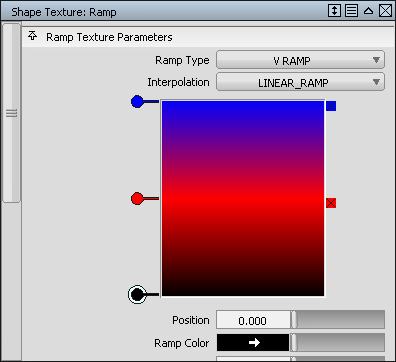

This window contains parameters that let you customize the ramp texture. You’ll do this later in the tutorial.

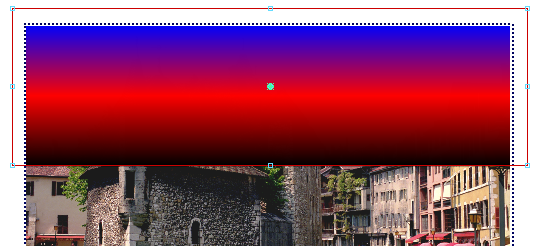

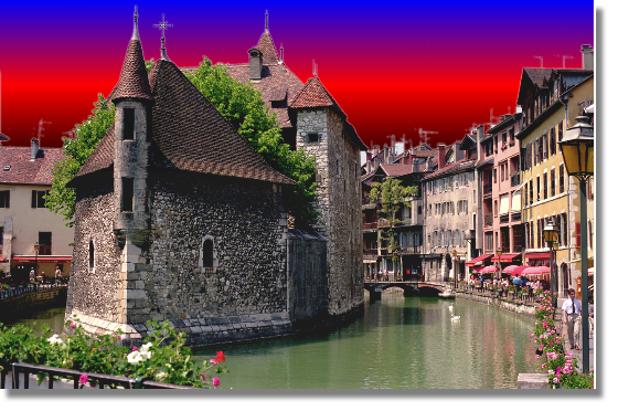

Next you’ll move the shape behind the image and modify the ramp texture so it appears more like an actual sky.
There are two layers in this sketch: annecy and Shape-# (where # is a number). annecy is an image layer (indicated by
) and Shape-# is a shape layer (indicated by
An image layer contains paint (in this case, an imported image) and a shape layer contains shapes. You cannot use a brush to paint or erase on a shape layer.

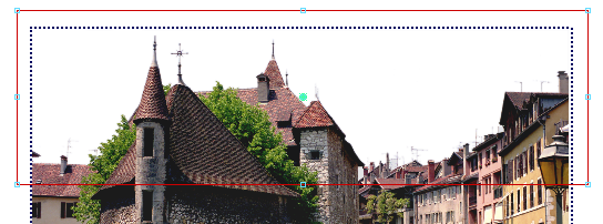

Drag the sky layer onto the annecy layer. When a red triangle pointing down appears on the annecy layer, release the
The sky layer is now beneath the annecy layer.
In this case, there is only one shape on the layer: Shape-rectangle.
It becomes highlighted in yellow.
The shape’s name appears in the Paint Panel above the Display options.
Notice how the shape’s fill changes.
The black handle at the bottom left corner of the ramp is highlighted in white indicating that it is the active handle.
