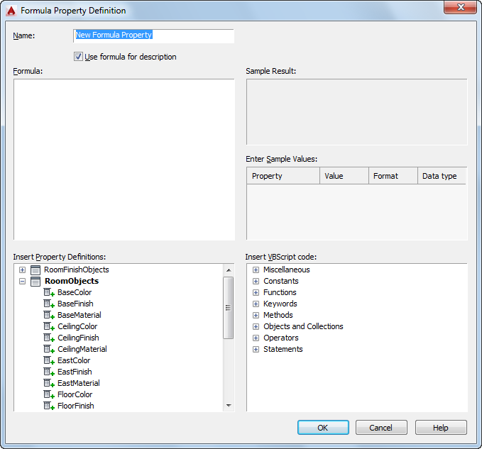

Use this procedure to add a formula property definition to a property set definition. Formula property values can be computed based on the values of other property data. A formula property definition is a type of automatic property, because the value it displays is determined automatically, based on its definition, and cannot be edited directly.
Formulas can be simple mathematical expressions, such as 2+2. They can also contain variables, operators, and functions allowed in VBScript, as shown in the examples below.

. The Style Manager is displayed with the current drawing expanded in the tree view.
 Property Set Definitions.
| If you want to… | Then… |
| use a value that you supply | click in the Formula pane, and enter the value. |
| use the value of another property definition in the formula | locate and double-click (or right-click, and click Insert) the definition in the Insert Property Definitions list. You can also select the definition, and press Insert. |
| use a VBScript function | locate and double-click (or right-click, and click Insert) the function in the Insert VBScript code list. You can also select the function, and press Insert. |
| evaluate the formula as a VBScript function | enter RESULT anywhere in the formula. |
The property definitions available for use in the formula must be applied to the same objects as the property set definition containing the formula.
The names of property definitions used in the formula are displayed within brackets, such as [Width]. If a property definition belongs to a property set definition other than the one containing the formula, that name is displayed as well, such as [DoorObjects:Height].
The formula property definition cannot be used in the formula it defines, as indicated by the
 and the addition of [Self] after its name. Property definitions that end up using the value of the formula cannot be used in the formula, as indicated by the
 and the addition of [Circular Reference] after their names.
The property value you enter displays with the current format specified in the Sample Result pane.
The format you select effects how the data in the Value column displays in the Sample Result pane and how the formula evaluates in the in the schedule table. It can be changed at any time.
