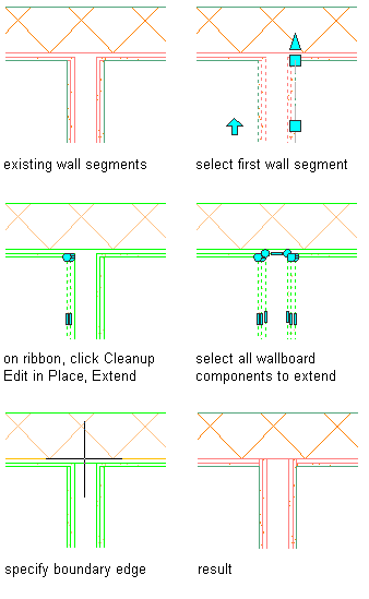

Use this procedure to modify a wall intersection by extending a component. The extension boundary can be a line, arc, circle, polyline, or wall component edge.
Vertex and Edge grips display for the first wall component, based upon the wall style index.
You can extend multiple components at a time to a extension boundary. Press Esc to clear component selection.

In the following example, wallboard components are extended to a concrete block component as the extension boundary to create a fire break.
