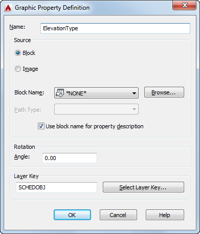

Use this procedure to add a graphic property definition to a property set definition. Graphic property values can be blocks in the current drawing or image files, such as BMP, GIF, JPG, PNG, or TIF. The image displayed cannot be edited directly.
Schedules display blocks as graphic properties only if the blocks exist in the current drawing and if the block is not annotative. If you copy a schedule or a schedule table style to a new drawing, make sure that you also copy all blocks.
| If you want to… | Then… |
| select a block from the current drawing | select Block, and select the block name from the drop-down list. |
| select a block from outside of the current drawing | select Block, click Browse, select a block, and click Open. |
| select a drawing file | select Block, click Browse, select a drawing, and click Open. |
| select an image file | select Image, and click Browse. In the Select Image File dialog box, browse to select the image, and click Open. Select the path type from the drop-down list. Using relative paths makes your project more portable. |
To change the name of the property definition, double-click the value for Name.
The format you select becomes the default format of a column when this property is added to a schedule table style. It can be changed at any time. The Example column shows how the default value is displayed using the selected format.
