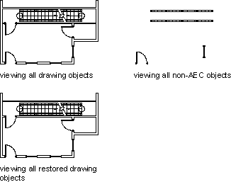

In the following illustration, the railing, door, and the framed opening are exploded AEC objects.
Performing a visual audit with AEC and non-AEC objects in the drawing
