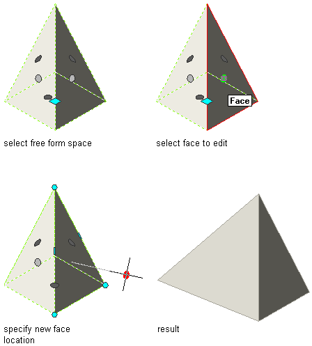

Use this procedure to grip-edit individual surfaces of a 3D freeform space.
You have 6 different options for grip-editing a space surface.

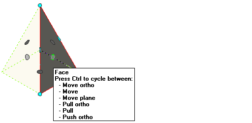

As you cycle through the options by pressing Ctrl, the tooltip advances sequentially to indicate the current option. Pressing Ctrl more than 5 times returns you to the first option, allowing you to continue cycling through the edit choices.
The cursor is constrained when you choose an orthogonal option and unconstrained when you choose a free option.

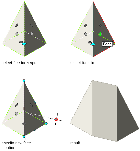

Moving a space surface orthogonally while stretching adjacent surfaces

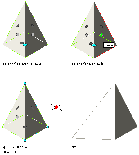

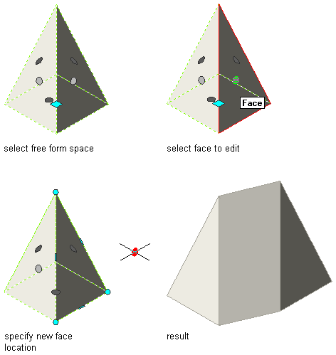

Moving a space surface freely while stretching adjacent surfaces

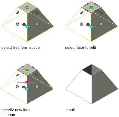

Moving a space surface orthogonally while maintaining the planes of adjacent surfaces

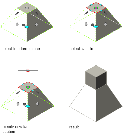

Pulling a space surface orthogonally while adding adjacent surfaces
Pulling a space surface freely while adding adjacent surfaces
Pushing a space surface orthogonally to create a hole
. The tooltip displays the available edit operations:
| If you want to… | Then… |
| move the space surface orthogonally while stretching adjacent surfaces | click the surface grip. Then, move it to the new position. |
| move the space surface freely while stretching adjacent surfaces | click and hold the surface grip, press Ctrl once, and specify the new location. |
| move the space surface orthogonally while maintaining the planes of adjacent surfaces | click and hold the surface grip, press Ctrl twice, and specify the new location. |
| pull the space surface orthogonally while adding adjacent surfaces | click and hold the surface grip, press Ctrl 3 times, and specify the new location. |
| pull the space surface freely while adding adjacent surfaces | click and hold the surface grip, press Ctrl 4 times, and specify the new location  Note: The location of the current UCS is temporarily moved to coincide with the original position of the surface grip that you select when you are working with this option. Only the UCS origin is changed, not its orientation.
| push or pull the space surface orthogonally while either adding adjacent surfaces or creating a hole | click and hold the surface grip, press Ctrl five times, and specify the new location.  Push into the space to create a hole, or pull out of the space to add adjacent faces.  |
