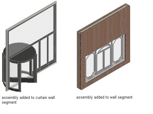

Door and window assemblies provide a grid or framework for inserting objects such as windows and doors. With this framework, you can create complex window and door assemblies, which can then be inserted in standard walls or used as repeated elements in curtain walls.

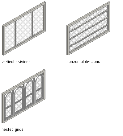

Door and window assemblies are made up of 1 or more grids. Each grid has either a horizontal division or a vertical division, but you can nest the grids to create a variety of patterns from simple to complex.

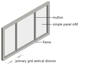

Grids are the foundation of curtain walls, curtain wall units, and door and window assemblies. Every grid has four element types:
Each element type is assigned a default definition that describes what elements of that type look like.
| Element type | Default definitions |
| Divisions | Vertical divisions with a fixed cell dimension of 3' |
| Cell Infills | Cells containing simple panels with a 2" thickness |
| Frames | Outer edges of grid 3" wide and 3" deep |
| Mullions | Edges between cells 1" wide and 3" deep |

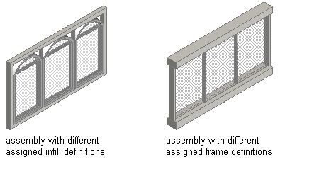

You can create new element definitions and assign those definitions within the door and window assembly. For example, you can create multiple infill definitions and then assign different infills to specific cells in the grid. Likewise, you can create multiple frame definitions and then assign a different definition to each frame edge (top, bottom, left, right). This is also true for mullion definitions.
