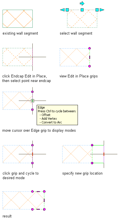

Use this procedure to offset a wall component edge with Edge grips.
If you want to... | Then... |
Save any changes you made during the edit-in-place session as a new style | click ![]() ![]() ![]() |
Discard any changes you made during the edit-in-place session | click ![]() ![]() ![]() |
Save any changes you made during the edit-in-place session | click ![]() ![]() ![]() |
In the following example, a wall component edge is offset with an Edge grip.
