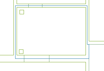

Bounding adjacency rules define an offset for segments of the space base profile depending on the space that is adjacent to this segment. A common use case for gross offset profiles is that bounding adjacency rules define that the boundary should be offset to the center of the bounding object at interior walls and to the outside of the bounding object at exterior walls.

The first ObjectId argument is the current space for which the offset boundary is to be calculated. The second ObjectId is the bounding object between the space from the first argument and the adjacent space. The third argument is the ObjectId of the adjacent space. When there is no adjacent space, which is the case at exterior walls, the value of this argument will be ObjectId.Null. The following example shows the frame for a new space rule called BoundingAdjacencyRuleGross:

The following example shows the implementation of a bounding adjacency rule that is used in the sample project. It defines an offset to the center of the bounding object for 2 spaces at interior walls and an offset to the outside of the wall if there is no adjacent space.
