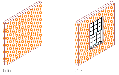

You can add a door or window to a wall by placing it freely on any wall point.
Inserting a window in a wall
Inserting a door in a wall
