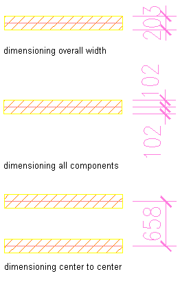

Length of Wall: Wall Length | Dimensions the length of each wall in the selection set. |
Wall Width: Overall | Dimensions the overall width of a wall. |
Wall Width: All Components | Dimensions the width of each component in a wall. |
Wall Width: Center | Dimensions the center line of a single-component or multi-component wall |
Wall Width: From Style | Dimensions the wall components according to the settings in the wall style. |

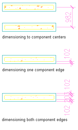

The dimensioning of wall components can be specified in 2 different locations: in the wall style and in the AEC dimension style.
In the wall style, you can set following information that is relevant to the dimension:
In the AEC dimension style you can define the following additional or overriding settings for dimensioning wall components:
