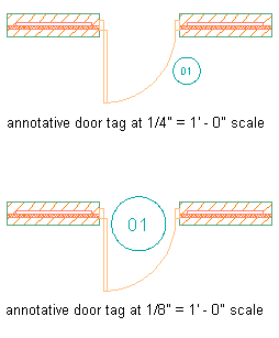

The following illustration shows a door tag shown at two different annotation scales and different locations based on the annotation scale and base point.

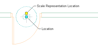

Annotative objects such as door tags now have a Scale Representation Location Grip. Use this grip to relocate the current scale representation instance. Use the Location grip to relocate all of the scale representations at once. If there is only one scale representation supported for a particular tag, only the Location grip is displayed.
