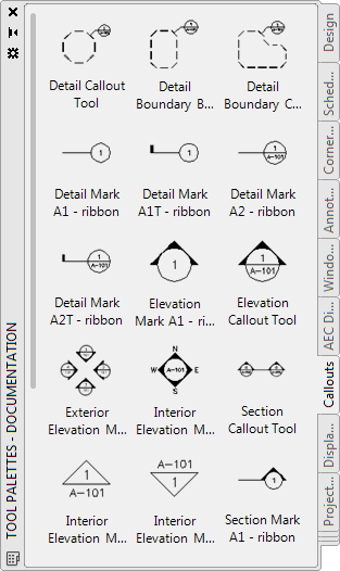

AutoCAD Architecture provides a number of predefined annotation tools that use different kinds of fields. For example, keynote tools use keynote fields, while callout tools use sheet set fields.
You can also use fields to create your own annotation tools.
Callout tools in AutoCAD Architecture
