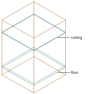

Use this procedure to define any of the following display components of a space in the style:
Note: If a material assignment determines the display properties of components in the space style, you can change the properties of the display component by clearing By Material. You can also override the material assignment with a different material.

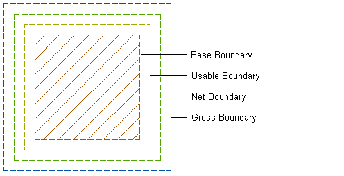

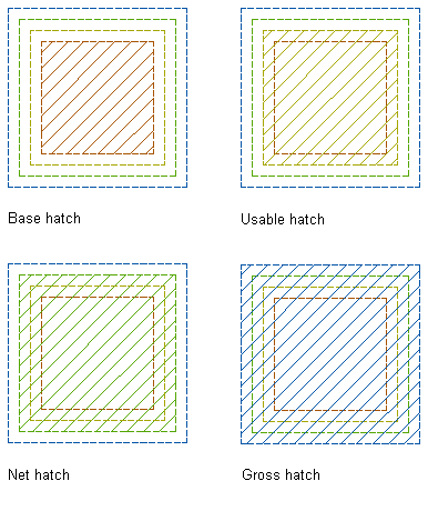

- Select the space component to change, and change the following settings:
- Material: If you select By Material, all display settings are taken from the assigned material. Components that cannot be set by material have the check box deactivated.
- Visibility
- Layer
- Color
- Linetype/Lineweight/Linetype Scale
- Plot Style
