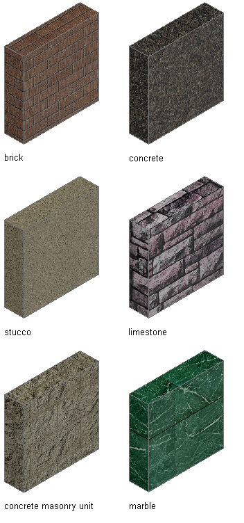

Wall segments with assigned materials in realistic visual style
