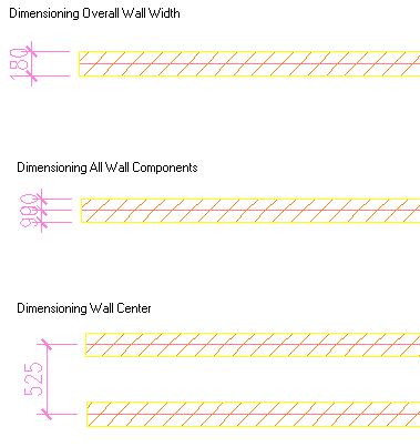

You have various options for dimensioning individual wall components. In the wall style, you can define the dimension settings for each individual wall component. Each component can be dimensioned to one or both of its edges, as well as to the component center. You also can select to not dimension a specific component at all.
- Component side to dimension: In the wall style, you can define for each wall component whether it should be dimensioned to its positive or negative side, or to the center of the component. The positive and negative sides of a wall are determined by the direction in which the wall is drawn: if you draw a wall from left to right, the positive side is the left (top). If you draw a wall from the right side to the left, then the positive side is the right (bottom). If you determine that a wall component is only dimensioned to one side, you can select either the positive or negative side of the wall

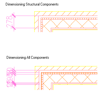

- Structural Function: You can define a wall component as structural or non-structural. When you set up the AEC dimension style you can define that only structural wall components, or all wall components should be dimensioned.
Alternatively, you can select to dimension a multi-component wall not to each individual component, but to the overall wall width or the overall wall center. You set these points in the AEC dimension style.
In the AEC dimension style you can define the following additional or overriding settings for dimensioning wall components:
- By Style: the dimension points selected in the wall style are used to dimension the wall components width.
- Structural by Style: the dimension points specified for the structural components of the wall style are used.
- Overall: the overall width of the wall is dimensioned.
- Center: the center of the wall is dimensioned.
