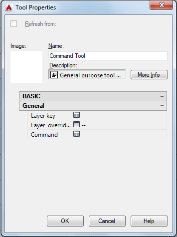

- On the tool palette, select the command tool, right-click, and click Properties.
Command tool properties
- Change the following tool properties as necessary:
| Property |
Description |
| Name |
Lets you replace the generic command tool name with a name that describes the function of the tool. |
| Description |
Lets you add a more detailed description to the command tool. |
| Layer key |
Specifies the layer key to define the layer on which objects created with this command will be inserted. |
| Layer overrides |
Defines overrides for the selected layer key. |
| Command |
Specifies the command to be executed by the tool. The following command types are valid within the Command Tool: - AutoCAD and AutoCAD Architecture commands
- AutoLISP routines
- VBA macros and applications
- Scripts
| Image |
By default, the command tool has no associated image. To add an image that illustrates the function of the tool, right-click in the empty image area, and select an image. |
- Click OK.
