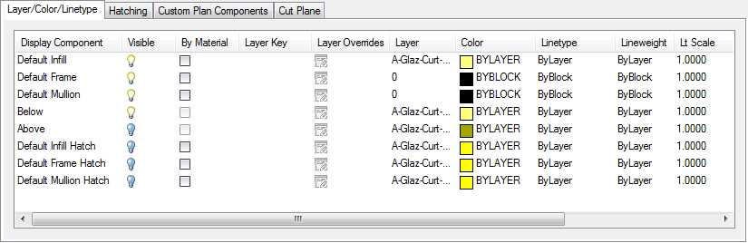

. | If you add a cut plane … | Then … |
| at a height that is lower than the value for Cut Plane Height | objects are displayed using the properties specified for the Below Cut Plane component on the Layer/Color/Linetype tab. |
| at a height that is higher than the value for Cut Plane Height | objects are displayed using the properties specified for the Above Cut Plane component on the Layer/Color/Linetype tab. |
Below and Above components
