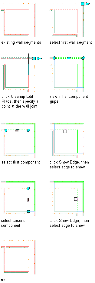

Use this procedure to modify a wall intersection by showing a previously hidden wall component edge.
Vertex and Edge grips display for the first wall component, based upon the wall style index.
You can only show the edge of one component at a time. Press Esc to clear component selection.
If you want to... | Then... |
Discard any changes you made during the edit-in-place session | click ![]() ![]() ![]() |
Save any changes you made during the edit-in-place session | click ![]() ![]() ![]() |
In the following example, previously hidden wallboard component edges are shown to create an interior corner condition.
