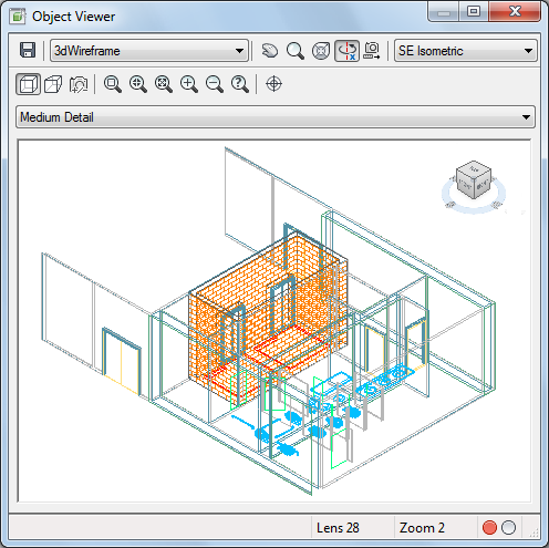

The Object Viewer lets you preview objects in your drawing with different visual styles, view directions, and display configurations without changing the display of the drawing area.
The Object Viewer can be started from different locations in the software. Depending on where the Object viewer is located the viewing and navigation options can vary. For example, if you use Object Viewer to preview an object from the drawing area, a compass is displayed. If you use the object viewer to preview a style in Style Manager, the compass is not displayed, since the style is not an object located in WCS or UCS.
You can select one or more objects in the drawing area, and preview them in the Object Viewer.

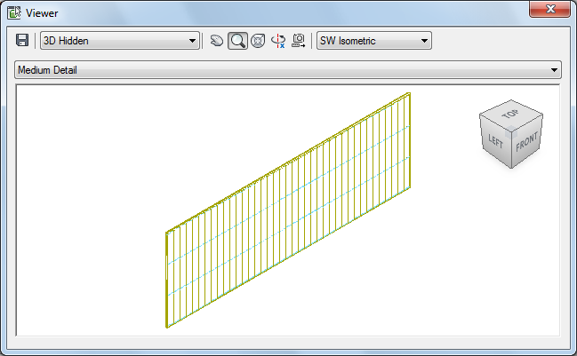

You can preview the effects of a style that you are creating in the Object Viewer (Floating Viewer) provided with Style Manager.
. Alternatively, you can click the
button (Inline Edit Toggle) to display the Object Viewer embedded inside Style Manager.

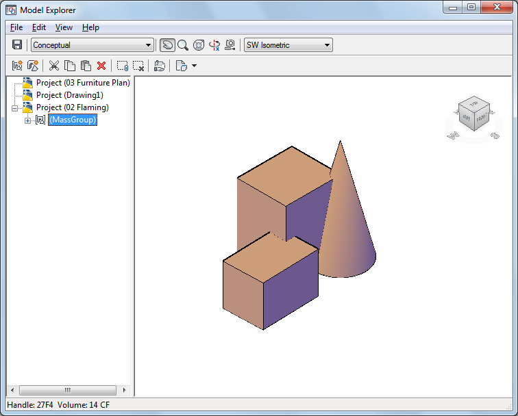

The Model Explorer is a window in which you create, view, and manipulate mass elements and mass groups. The Model Explorer uses the Object Viewer to let you preview the mass element and mass group operations you perform.

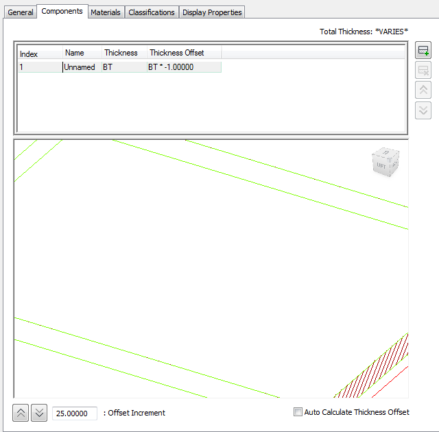

Embedded Object Viewer in Roof Slab style tab

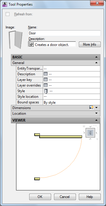

Embedded Object Viewer in tool properties
