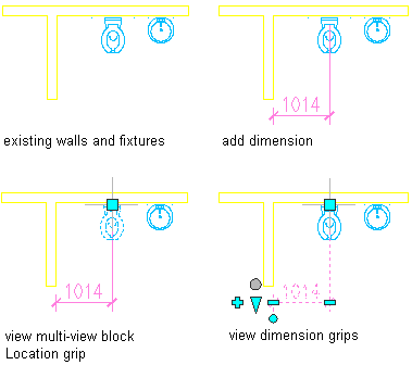

    dimension OSNAP points on objects (creates an associative dimension) verify that OSNAP is turned on. Enter p (Pick Points) on the command line, and select points on objects by snapping to them.

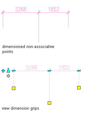

    dimension non-associative points in the drawing (creates a non-associative dimension) verify that OSNAP is turned off. Enter p (Pick Points) on the command line, and specify points in the drawing.

    Associative dimension picked on multi-view block
    Non-associative dimension
