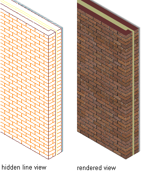

Assigning a material to components of an object will change how the object displays in plan, isometric, section, and elevation views.
For example, if you want to draw a brick exterior wall, you can assign a material that displays a brick surface hatch in model view and a realistic brick display for a rendered view.
Brick wall in hidden line and rendered views
If there are special insulation components in a wall, you can assign a light, half-transparent material to them. For sectioning the wall, you can assign a specific section hatch pattern or fill that differs from the regular brick surface hatch.
Section fill material in a rendering
