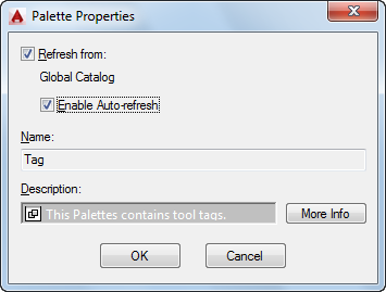

The text below the check box displays the name of the catalog in the Content Browser from which the palette is updated.
If you click that name, it opens the catalog from which the tool palette was linked.
| If you want to… | Then… |
| automatically update the linked tool palette from the Content Browser when starting AutoCAD Architecture | select Enable Auto-refresh. |
| update the linked tool palette manually with one of the methods | clear Enable Auto-refresh. |
The name of the tool palette in the Content Browser (from which the selected tool palette is updated) is displayed under Name.
