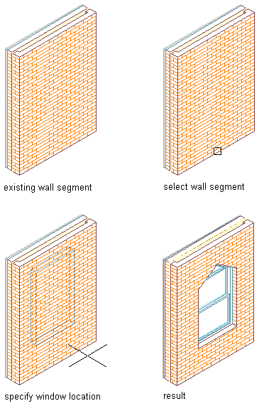

Adding a window to a wall

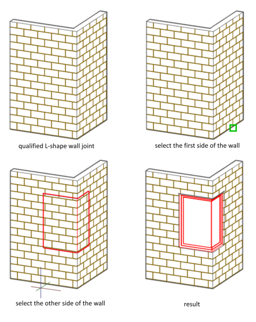

Adding a corner window to a L-shape wall joint

  13. Specify the insertion point for a freestanding window, window, or corner window in a wall:
    If you want to insert… Then…
    a freestanding window press Enter, and specify an insertion point and a rotation angle for the window.
    the window in a wall select the wall and specify an insertion point along the wall.
    a corner window in a wall select a qualified L-shaped wall joint. Specify an insertion point along the second wall.
