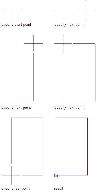

Use this procedure to add a new slab or roof slab that has the properties specified in the slab or roof slab tool you select.
You add the slab or roof slab by specifying points to define its perimeter as follows:
(You may have to scroll to display the desired tool.)
. | If you want to… | Then… |
| close the perimeter by drawing two edges that meet at a right angle | specify a point in the direction in which the perimeter is to close; then enter o (for Ortho). The edge is extended until it meets another edge perpendicular to the first edge. |
| close the perimeter by adding an edge from the previous point to the start point of the baseline | enter c (for Close). |
Drawing a slab
