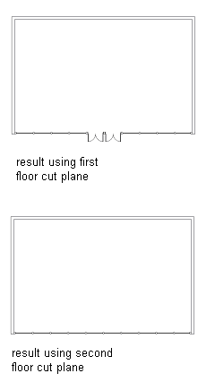

Usually, you want to display the cut plane of the current level. However, in some cases, you might want to display a different level. For example, you may want to see how a curtain wall that spans several levels in a project will display at each level.
Specifying different cut planes results

    For example, perhaps you have a 3-story building with a floor height of 2.75 meters for each floor. You have created a view of the first floor but want to display the second floor in it at a cut height of 1.4 meters. In the Cut Plane dialog box, you enter 2 for level, and 1.4 for Cut Plane Height Above Level. When you click OK, the display range of the view now spans the second level. The following values are entered into the Cut Plane Tab of the display configuration:
    Field Name Value Comment
    Display Below Range 2.75 meters This is where the second level starts.
    Cut Height 4.15 meters (2.75 meters + 1.4 meters) To display a cut height of 1.4 meters, add 1.4 meters to the start of the second level at 2.75 meters.
    Display Above Range 5.5 meters The second level starts at 2.75 meters, and has a base height of 2.75 meters. This results in an overall height of 5.5 meters.
