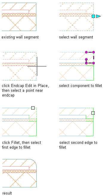

Use this procedure to modify a wall endcap by filleting a wall component.
You may only fillet the corner of one component at a time. Press Esc to clear component selection.
If you want to... | Then... |
Save any changes you made during the edit-in-place session as a new style | click ![]() ![]() ![]() |
Discard any changes you made during the edit-in-place session | click ![]() ![]() ![]() |
Save any changes you made during the edit-in-place session | click ![]() ![]() ![]() |
In the following example, a brick veneer corner is filleted.
