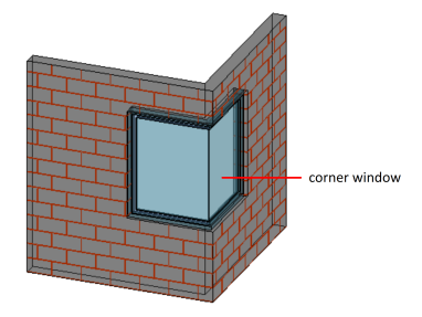

About Corner Window
A corner window extends from one wall to the other after being inserted at a qualified corner junction of two walls. A qualified corner junction has:
A corner window has two opening widths.
  • Width 1: Width 1 is the opening width of the first wall you specify when you insert a corner window. Width 1 is also anchored to the first wall you specify.
  • Width 2: Width 2 is the opening width of the second wall you specify when you insert a corner window.
Note: Width 1 and 2 of the corner window is determined by the opening width measure that you can change from the Properties palette.
Create corner window that supports both corner window frames or butt glazing. To create a corner window with butt glazing.
Inserting the corner window results in the following:
  • The window is automatically cleaned up with the qualified wall joint.
  • The window panes are spread perpendicularly to each wall. The inner angle of the corner window is automatically adjusted to the wall corner.
  • Changing the angle of the L-shaped wall corner junction automatically adjusts the angle of the corner window. The opening width values of the corner window are not changed. Only the angle of the corner window is changed, corresponding to the angle of the wall corner.
  • Removing either walls of the L-shaped wall corner junction automatically deletes the corner window.
