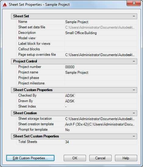

- Select the root node of the sheet set, right-click, and click Properties.
- Expand Sheet Set.
- To define page setup overrides in the project, click the setting for Page setup override files.

- Expand Sheet Creation.
In this category, you define settings for the sheets you create within the sheet set.

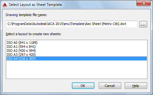

- To define a default template for new sheets, click the setting for Sheet creation template.
- Click
to browse for a drawing (DWG) or template (DWT) file, and click Open.
- Select the default layout you want to use to create new sheets. Then, click OK.
- Specify if you want to be prompted for the sheet template each time you create a new sheet:
| If you want to… |
Then… |
| be prompted for a sheet template each time you create a new sheet |
select Yes. |
| always use the default sheet template |
select No. |
- To add, edit, or delete custom properties, click Edit Custom properties.
Note: When working in an AutoCAD Architecture project, you can also use the project properties.
- Click OK.
