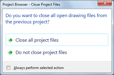

Use one of the following methods to close all drawing files in the current project.
 Close
 All Project Drawings. This option closes all of the project drawings but leaves the project current and the Project Navigator displayed.
| If you want to… | Then… |
| always close all project files, close the Project Navigator, and exit the project environment when you click  |
select Always perform selected action, and then click Close all project files. |
| always close the Project Navigator and exit the project environment but leave all project files open, when you click  |
select Always perform selected action, and then click Do not close project files.  This option lets you work on the files outside the project environment so that you do not accidentally make changes to the project.  |
| close all project files, close the Project Navigator, and exit the project environment for this instance | click Close all project files. |
| close the Project Navigator and exit the project environment but leave all project files open for this instance | click Do not close project files.  This option lets you work on the files outside the project environment so that you do not accidentally make changes to the project.  |
