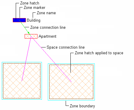

- For Zone boundary offset, enter a value to specify the distance you want between the zone boundary and the base boundary of any attached space.
If you select 0 offset, the zone boundary is identical to the base boundary of the space.
Zone boundary offset at 0 (left) and at an offset value (right)
Tip: If you cannot see the zone boundary, the display component for the zone boundary may not be activated in the zone style.
