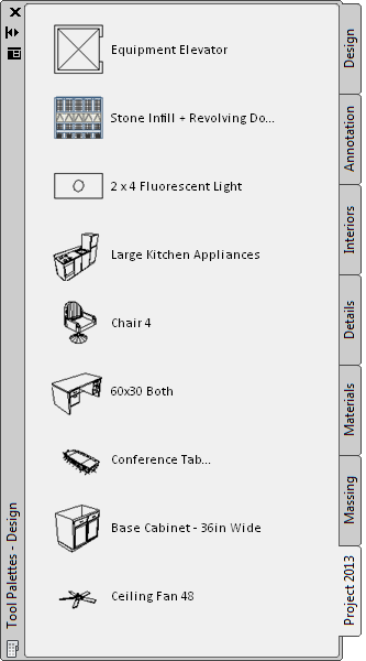

AutoCAD Architecture tool palette set, with added tool palette
Once added to the tool palette set, the palette remains a part of the set and is available each time you start AutoCAD Architecture.
