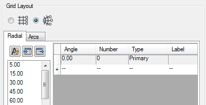

- In the Column Grid dialog box, click the Radial radio button.
- Click the Radial tab.
- To add the first bay to the grid, determine the desired angle (for example 15°) and click the corresponding value in the value list on the left.
Tip: You can either directly edit the bay angle value after entering it, or you can edit the list of preconfigured default values.
- For a grid with regular angles, you have two options of generating grid Bays:
- Under Type, select if the grid line limiting the bay should be labelled as primary grid line or secondary grid line. By default, primary grid lines are chosen.
Note: The Label column is a read-only column showing you the grid label for the associated grid line. You can change the labeling of the grid under Bubble Parameters below.
- Enter a value for the inner radius of the grid.
- Define if the grid should be developed in clockwise or counter-clockwise direction.
