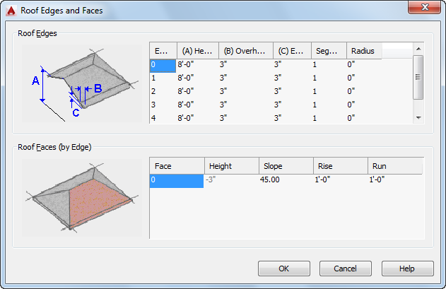

Use this procedure to edit the edges and faces of a roof. You can edit:
As you select edges, they are numbered consecutively, beginning with zero, for display in the dialog box.
| If you want to… | Then… |
| change the height of a roof edge | select Height for the roof edge, and enter the height value. |
| change the overhang of a roof edge | select Overhang for the roof edge, and enter the overhang value. |
| change the number of segments in a curved roof for a roof edge | select Segments for the roof edge, and enter the number of segments. |
| change the radius of the curved roof edge | select Radius for the roof edge, and enter the radius. |
| change the height of a roof face | select Height for the roof face, and enter the height value. |
| change the slope of a roof face | select Slope for the roof face, and enter the slope value. |
| add a face to the selected edge | click the blank space under the last number in the Face column, and enter values for Height and Slope. |
| remove a roof face | select the Face column number, and press Delete. |
