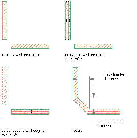

Use this procedure to chamfer 2 walls. Chamfering walls creates a new wall segment between 2 walls that are not parallel. Chamfering is useful when you are working with unique wall angles or architectural details.
You can chamfer walls by specifying distance or angle:
Chamfering wall segments using the distance option
Trim mode options allow you to specify whether the walls are trimmed or extended to the new wall segment (trim option) or whether their endpoints remain unchanged (no trim option). If you select no trim, chamfer distances must be greater than zero.
Before chamfering walls, ensure that the walls have the same style and baseline justification. Solution tip icons may display when you chamfer the walls if these settings are not the same for each wall.
The Chamfer tool is located with the Drafting Tools in the Stock Tool Catalog in the Content Browser. You can add this tool to any tool palette, and then use the tool to chamfer walls and other objects.
