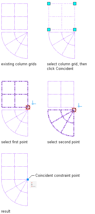

Working with the Coincident constraint
The Coincident constraint constrains 2 points to coincide. The constrained points can lie directly on an AEC object, or the extension of an AEC object. The Coincident constraint also works between appropriate AEC objects and AutoCAD objects, such as a wall segment and a line.
Use a Coincident constraint to anchor 2 column grids together.
The selected point is shown with a red circle and X through its center.
When you move one of the column grids, the other one moves with it. You can also rotate one of the column grids about the Coincident constraint point. To fully constrain both grids, add another Coincident constraint to the other column grid corner.

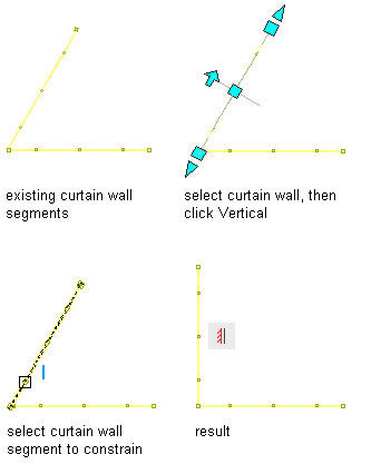

Working with the Vertical Constraint
The Vertical constraint constrains lines or pairs of points on AEC objects to lie parallel to the Y-axis of the current UCS. When you specify 2 points to vertically constrain, the second point is made vertical to the first point.
Use a Vertical constraint to realign a curtain wall segment vertically.
The curtain wall segment end closest to the specified point becomes the pivot point.

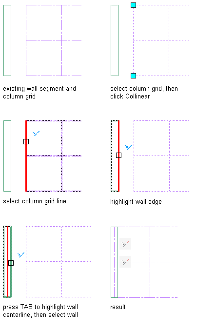

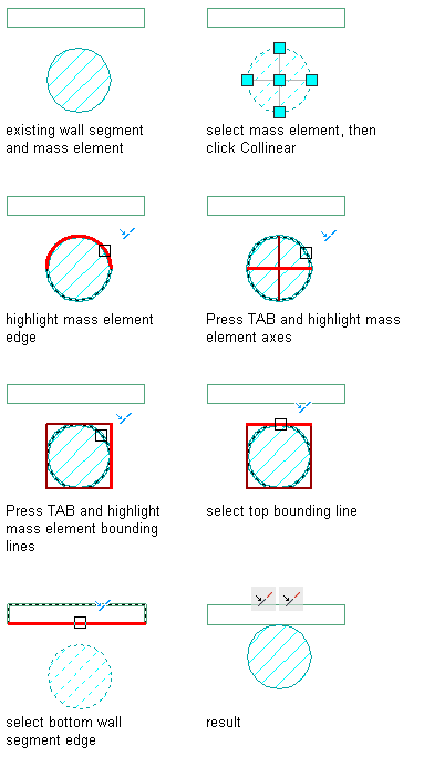

Working with the Collinear Constraint
The Collinear constraint aligns one AEC object with another. The second selected AEC object is made collinear with the first selected AEC object. You can align edges or centerlines of AEC objects as necessary. The Collinear constraint also works between appropriate AEC objects and AutoCAD objects, such as a column grid and a line.
Use a Collinear constraint to align the centerline of a wall with a column grid line.
The grid line is highlighted with a red line.
The wall segment edge is highlighted with a red line.
The wall segment centerline is highlighted with a red line.
Use a Collinear constraint to align the edge of a mass element with the edge of a wall segment.
The top edge of the mass element is highlighted with a red line.
The X axis is highlighted with a red line.
The right bounding box line is highlighted with a red line.

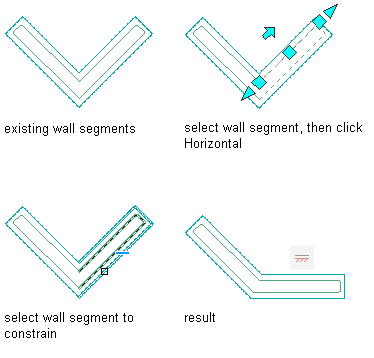

Working with the Horizontal Constraint
The Horizontal constraint constrains lines or pairs of points on AEC objects to lie parallel to the X-axis of the current UCS. When you specify 2 points to horizontally constrain, the second point is made horizontal to the first point.
Use a Horizontal constraint to realign a wall segment horizontally.
The wall segment end closest to the specified point becomes the pivot point.

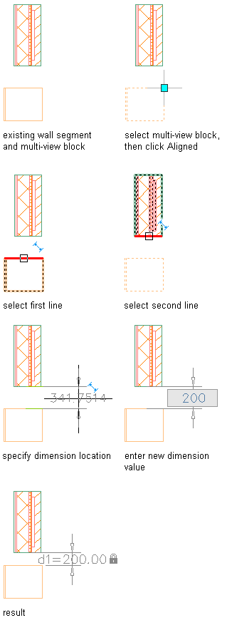

Working with the Aligned Constraint
The Aligned constraint maintains the distance between 2 parallel elements on 2 different AEC objects.
Use an Aligned constraint to maintain a specific distance between a wall segment and a multi-view block.
When you move either AEC object, the specified distance between them is maintained.

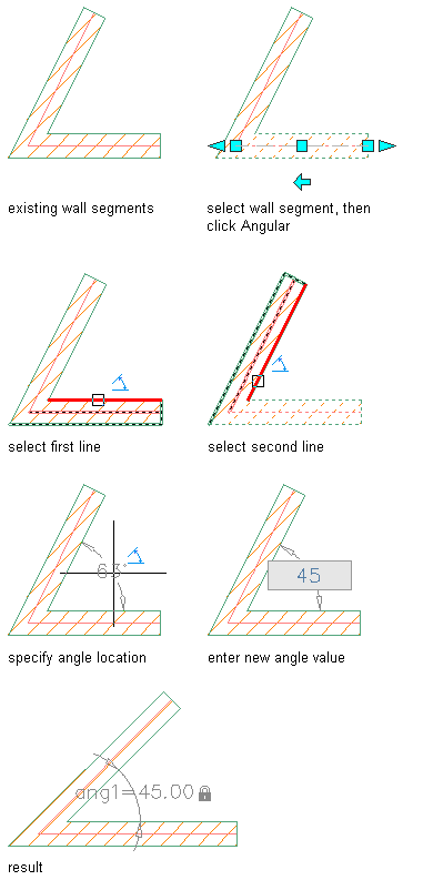

Working with the Angular Constraint
The Angular constraint maintains a specific angle between 2 AEC objects. The Angular constraint also works between appropriate AEC objects and AutoCAD objects, such as a wall segment and a line.
Use an Angular constraint to maintain an angle between 2 attached wall segments.
When you move either AEC object, the specified angle between them is maintained.

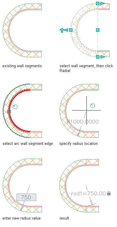

Working with the Radial Constraint
The Radial constraint maintains a specific radius of an AEC object. The Radial constraint also works between appropriate AEC objects and AutoCAD objects, such as a wall segment and a line.
Use a Radial constraint to maintain the radius of an arc wall segment.
