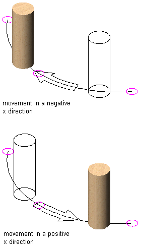

You can change the position of an anchored object relative to the curve in the X, Y, and Z directions. You can also rotate and flip the object along its axes.
Location on Curve. | If you want to… | Then… |
| change the X reference point on the curve | select Start of curve, Midpoint of curve, or End of curve for From. |
| specify the X distance between the reference point on the curve and the anchored object | enter a value for Distance. |
| select from which point on the anchored object the X distance to the curve is measured | select Start edge of object, Center of object, or End edge of object for To. |
Moving an object along a layout curve in the X direction

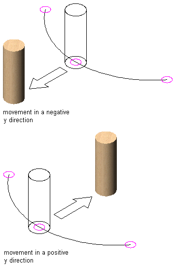

| change the Y reference point on the curve | select Left edge of curve width, Center of curve width, or Right edge of curve width for From. |
| specify the Y distance between the reference point on the curve and the anchored object | enter a value for Distance. |
| select from which point on the anchored object the Y distance to the curve is measured | select Front of object, Center of object, or Back of object for To. |
Moving an object along a layout curve in the Y direction

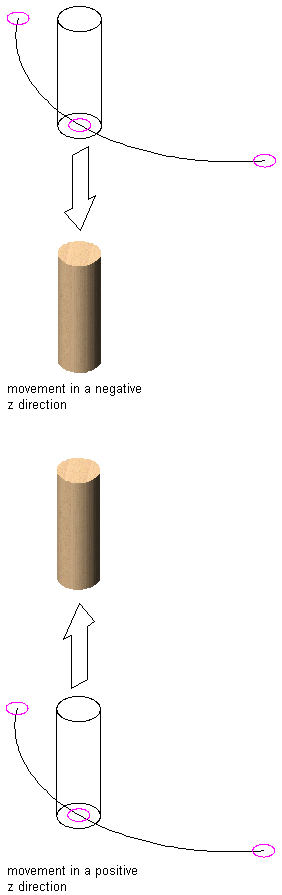

| change the Z reference point on the curve | select Bottom of curve height, Center of curve height, or Top of curve height for From. |
| specify the Z distance between the reference point on the curve and the anchored object | enter a value for Distance. |
| select from which point on the anchored object the Z distance to the curve is measured | select Bottom of object, Center of object, or Top of object for To. |
Moving an object along a layout curve in the Z direction
