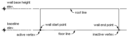

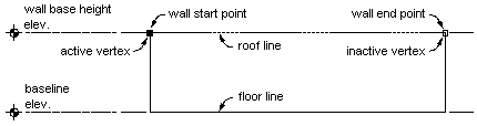

You can modify the roof and floor lines of a curtain wall to create a non-rectangular curtain wall:
Modifying the roof line of a curtain wall
Modifying the floor line of a curtain wall
