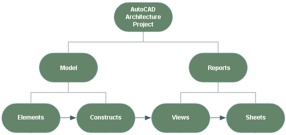

The Drawing Management feature of AutoCAD Architecture lets you create large building projects distributed among many drawing files.
A construct describes one unique portion of a building and is assigned to a specific level and division within the project. Spanning constructs, like curtain walls, can be assigned to multiple levels and divisions.
For example, the first level of your building project may consist of an exterior shell construct, a first-level core construct, and a first-level interior partitions construct.
A construct can contain drawing objects like walls and doors, external references to elements, or a combination of both. For example, a first-level core construct can contain the core walls directly drawn into the construct and an elevator element inserted as an external reference.

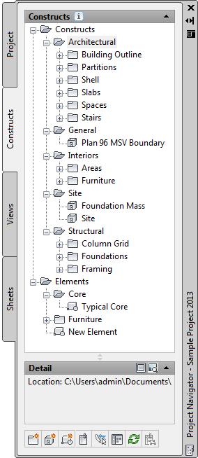

You can create and modify constructs within the current project. You can also import drawings and convert them or add them to constructs. You can import constructs into the project physically or by creating a link.
Constructs are referenced into views.
After the structure of the building is defined, and constructs are assigned to levels and divisions, you can generate reports (views and sheets) from the building model. A view automatically references a number of constructs to present a specific view of the building project. To create a view drawing, you first decide what portion of the building you wish to look at and the type of view to generate. You could, for example, create a first-floor reflected ceiling plan or a second-floor framing plan.

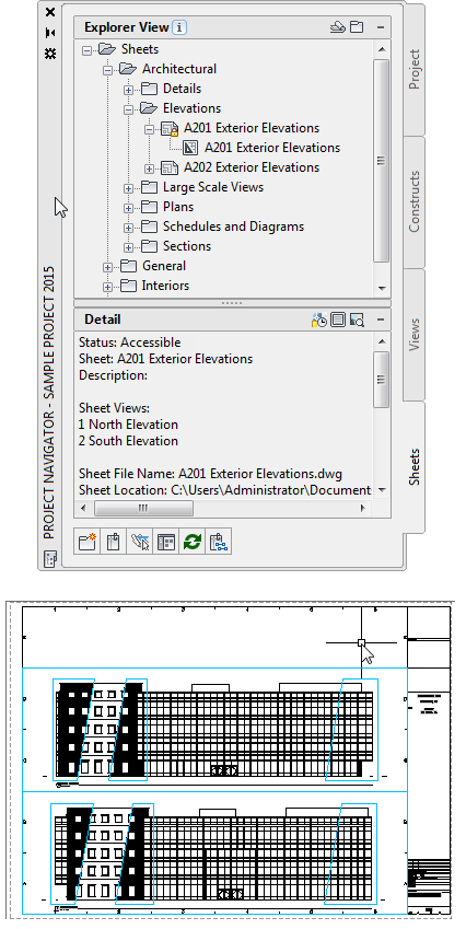

Views are referenced into sheets.
Sheets are used to plot drawings of your building project.

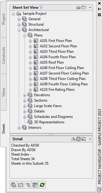

The sheet system in AutoCAD Architecture consists of the following components:
Sheet with building plan sheet view
Sheet view created from model space view
Sheet set for AutoCAD Architecture project
Each project in AutoCAD Architecture has a simple project sheet set, which contains all sheets for the project.
Sheet set, sheets, sheet views, sheet drawings, and model space views are listed on the Sheets and Views tabs of the Project Navigator.
Although it is recommended to place annotation in a view, you can add annotation like tags, dimensions, and schedule tables to a sheet.

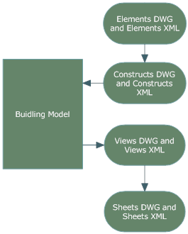

A AutoCAD Architecture project has an underlying XML structure. For each drawing file you create—for example, a floor drawing or a structural drawing—an accompanying XML file is created. The XML file contains project-relevant information, such as level and division information. You can reuse any drawing file created within a project outside the project as well, because the drawing file itself does not contain project-relevant information.

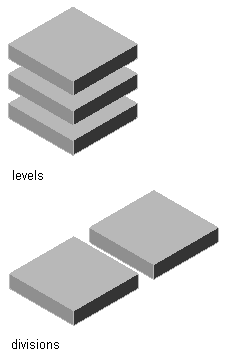

The project provides a framework of levels (floors) and divisions (wings) that specify where in the building project constructs are located. By default, a new project consists of one level and one division. You can add levels and divisions throughout the lifetime of a project. The matrix of levels and divisions provide the framework to help uniquely identify the building components. For example, you could have a construct in your building assigned to First Floor—West Wing.
Levels and divisions schematic

To help organize the building, components of the building project—constructs, views, and sheets—can be categorized. You can use categories like shell, core, and interior partitions. Categorizing a construct lets you filter that construct when generating views.
Construct categories in the Project Navigator
