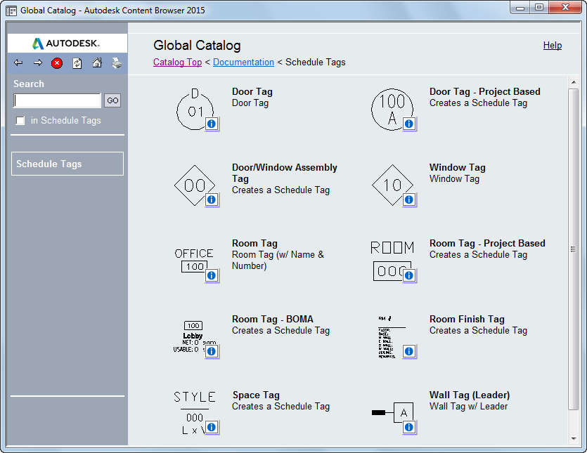

Content Browser showing Details palettes in Sample Palette Catalog
icon for the palette (or double-click the palette, and click the i-drop icon for a tool on that palette), and then drag the palette or tool onto the open palette in the workspace. If you are copying an entire palette from the Content Browser, a new palette is added to the set.
