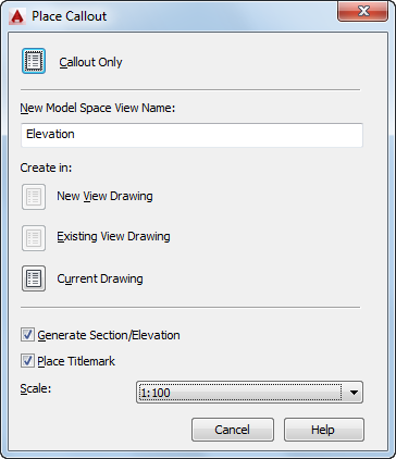

- Under New Model Space View Name, enter a name for the model space view containing the first elevation.
- Verify that Generate Section/Elevation is selected.
- If you want to add a title mark to the new model space views, select Place Titlemark.
- Select the scale for the model space view.
- Select where to place the elevation:

| place the elevation in the view drawing in which you placed the callout in |
click Current Drawing. |
| place the elevation in an existing elevation view drawing |
click Existing View Drawing. |
| place the elevation in a new elevation drawing |
click New View Drawing. |
